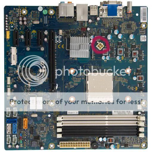

    did you plug in the suplimental power connector to the mother board? its the white 4 pin plug located near the CPU.
