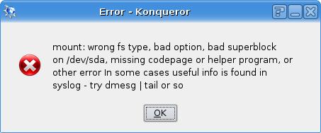

    I would like, pretty please to use my 2GB USB drive but I can not get my head around what is happening....
    When I stick the drive in, a message comes up telling me that a new removable medium is present! Hurrah!! But when I click on open in a new window it gives me the attached error message.
    Here is the output of "dmesg | tail":
    I have googled but all I can find are instructions to manually mount USB drives. That is fine and work a treat but I would prefer for the process to be automatic.
    Any ideas???

    Hmm, maybe need a little more info... how about the /etc/fstab, the distro/build, kernel version, and output of /etc/debug (if you're using a Debian derivative)?

    I am using Debian which started off as Etch (I am using the 2.6.18-6-686 kernel) but everything else is more or less Lenny. I tried using the 2.6.25 Kernel but kept getting terrible locks and freezes :(
    Note: as you know, Debian does not set-up a USB group so I created one (GID=500 purely experimental :p) and I am a member of it.
    Also the line - none /proc/bus/usb usbfs devgid=500,devmode=664 0 0 was inserted as a recommendation by the VirtualBox manual in cases of permission access to the USB filesystem. It is coupled with domount usbfs usbdevfs /proc/bus/usb -onoexec,nosuid,nodev,devgid=500,devmode=664 in /etc/init.d/mountkernfs.sh
    Sorry about the rant... it was a very long day with a frustrating end to it.... :mad:
  4. Anti-Trend
    Well, that kernel version does posses a bug present in all pre-2.6.21 kernels which affects FAT-formatted USB media under some circumstances. :( So, you could try the stock Lenny kernel, or try your hand at building your own from vanilla.

  6. Anti-Trend
    Essentially you just need to run a kernel newer than 2.6.21.
  7. sabashuali
    sabashuali Ani Ma'amin
    6
    Thanks.... five minutes later I tried using the 2.6.25 and the drive mounted beautifully.... so I get it now. I am trying at the moment to compile a new 2.6.26.... if this does not work, I will see if Sid has anything to offer....
