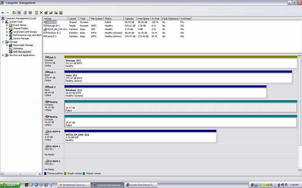

    i went to install vista ultimate from cd in windows, but when it asks me which drive i want to install on, it wont allow itself to be installed on the one drive i want it on. The drive i want it installed on is my Maxtor 300GB IDE drive. There is nothing wrong with the drive that i know of, because i had it as a secondary storage drive. now it says in a caution box when i have the drive selected...:
    "This computers hardware may not support booting to this disk. Ensure that this disk's controller is enabled in the BIOS menu.
    note*i performed a full fresh reformat via manage disks within windows

    To resolve this problem, follow these steps:
    1. Create one or more partitions on all the hard disks that are not initialized.
    2. Restart the computer.
    3. Install Windows Vista.
    i don't remember a step in xp having to initialize a disk and then format . :confused: ..only thing i remember ever having to do was install the hard disk and then right click then format. how am i supposed to do an initialization only? my maxtor has already been formatted , so how would i even start the process since windows sees it?

  20. Karanislove
    wat are those missing/striped HDD's???
