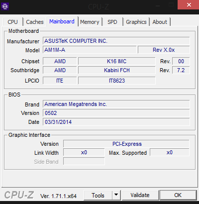

    I was looking to upgrade my current hardware with the Radeon R9 270x.. however i'm a complete newbie and wanted to check I wasn't wasting my time.
    https://33.media.tumblr.com/9071814ff812a95eeb1dde299f6ee6fc/tumblr_ngc6k7ySNW1u5xlayo2_500.png
    https://33.media.tumblr.com/9bda9b3edf74261a1bce1db5ae692e2a/tumblr_ngc6k7ySNW1u5xlayo3_500.png
    https://38.media.tumblr.com/dfb0fceebd7f2c53401dffb4a76e1d9f/tumblr_ngc6k7ySNW1u5xlayo4_500.png
    These are my current specs
    I'm concerned if I have the correct board and power supply
    The card I intend on getting http://www.sapphiretech.com/presentation/product/product_index.aspx?pid=2037&lid=1
    Thank you for taking the time to view/answer and I apologise for being a complete tool.
  2. Wicked Mystic
    Wicked Mystic Big Geek
    53
    28
    That processor is very slow and motherboard only has x4 PCI Express slot. That video card should however be compatible.
    What is power supply manufacturer and exact model?
  3. JoeMadden
    JoeMadden Geek Trainee
    The power supply is a corsair vs350 which I believe is 'budget-range' at best... all in all a weaksauce computer which I wanted to start beefing up.
    I've seen the R9 270x needs 2x PCI-e pin connector to power, so is a 500w with this connector recommended?
    thanks for taking your time to reply.
  4. Wicked Mystic
    53
    28
    R9 270x rated max power is 180W so PSU should be enough because CPU takes only 25W max.
