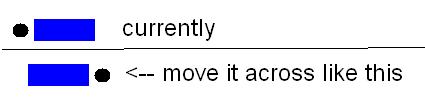

    if you locate the jumper next to the battery you will see that there is a pin free (2 pins on the jumper and one spare) pick up the pin and move it across one space so it coveres the other pin AND the other one, keep it locked in that position for about 10 secs then put it back to what it was
    see pic below... the jumper (blue) might be vice-versa from illistration. the black thing is the pin

    ok. i done that. there is good and bad news :p
    Bad : i bent one of the pins of the jumper, it didnt brake, i just bent it back into place, it is not loose its hard and not dangling :p
    Good : The BRMMMM noise is only made once when i start up the pc for half a second, then its just the cd-rom looking for a disk noise.
