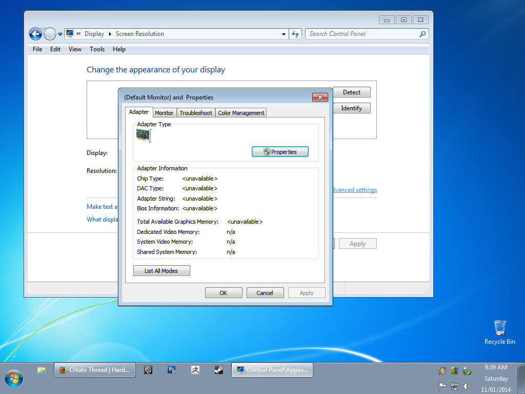

    Hey guys, I upgraded an older machine to Windows 7 from Windows XP when I heard they were going to discontinue XP finally, and everything went fine, except for one thing: my new OS now won't recognise my GPU (Nvidia 9800GT). It's especially bizarre because my monitor is plugged into the GPU, not the motherboard, and it's working fine. Well, fine aside from the fact that I can only choose from 4 resolutions in the control panel, none of which are my monitor's native resolution.
    So far, I have tried installing every single Windows update available, physically uninstalling and reinstalling the GPU, and installing the GPU to another machine (it works fine still), all to no avail, nothing has changed at all. I should also mention that attempting to install Nvidia drivers or the GeForce Experience program both result in a failure with the error message stating that I do not have an Nvidia product installed.

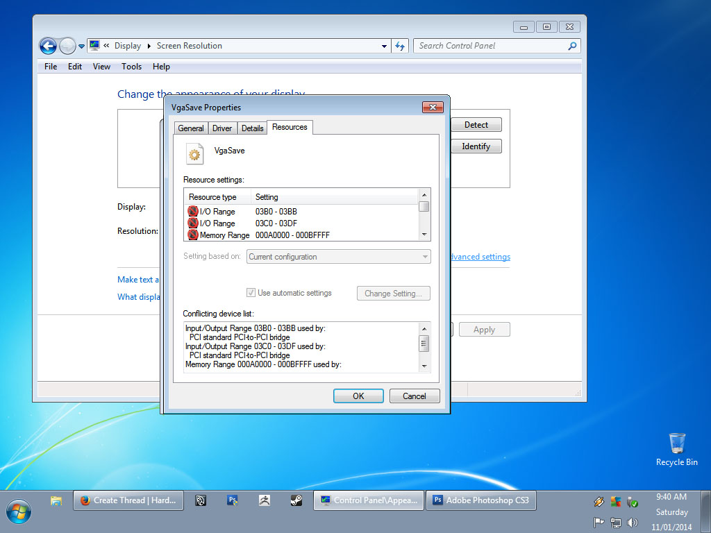

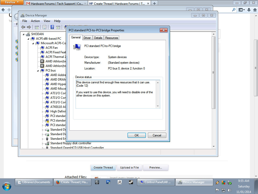

    One other thing to note, I also have a PCI-to-PCI controller conflict, which I believe is related. It seems to be sharing a physical address with the motherboard VGA adapter, and I'll attach some screens to show what's going on there. I'll also attach my system profile in case I forgot to mention anything. I know enough to recognise that there's something wrong here, but not enough to know what to do about it!

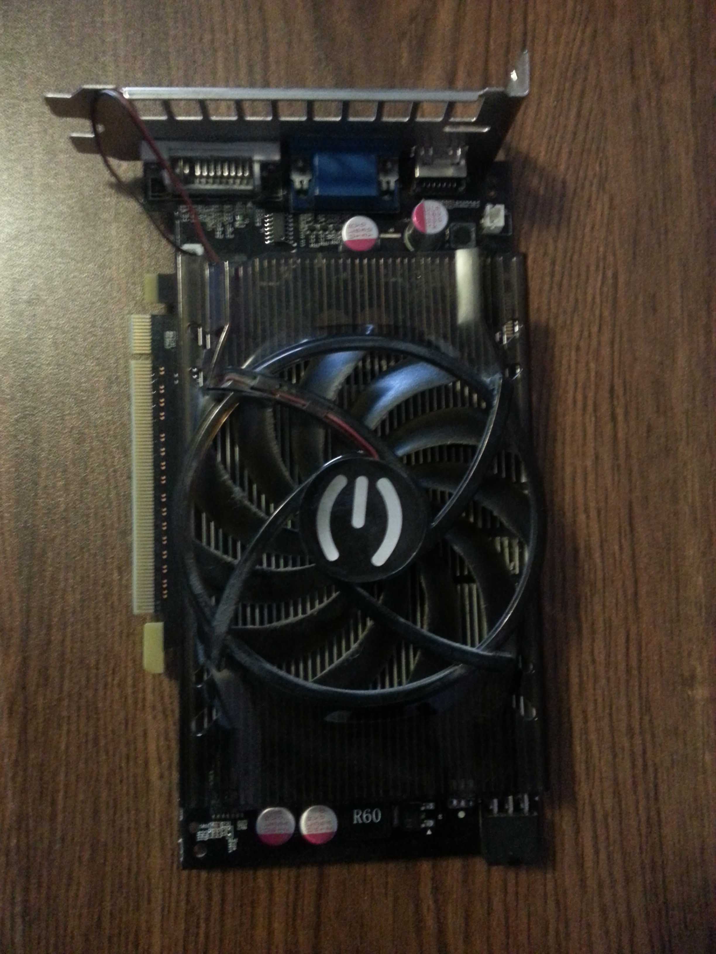

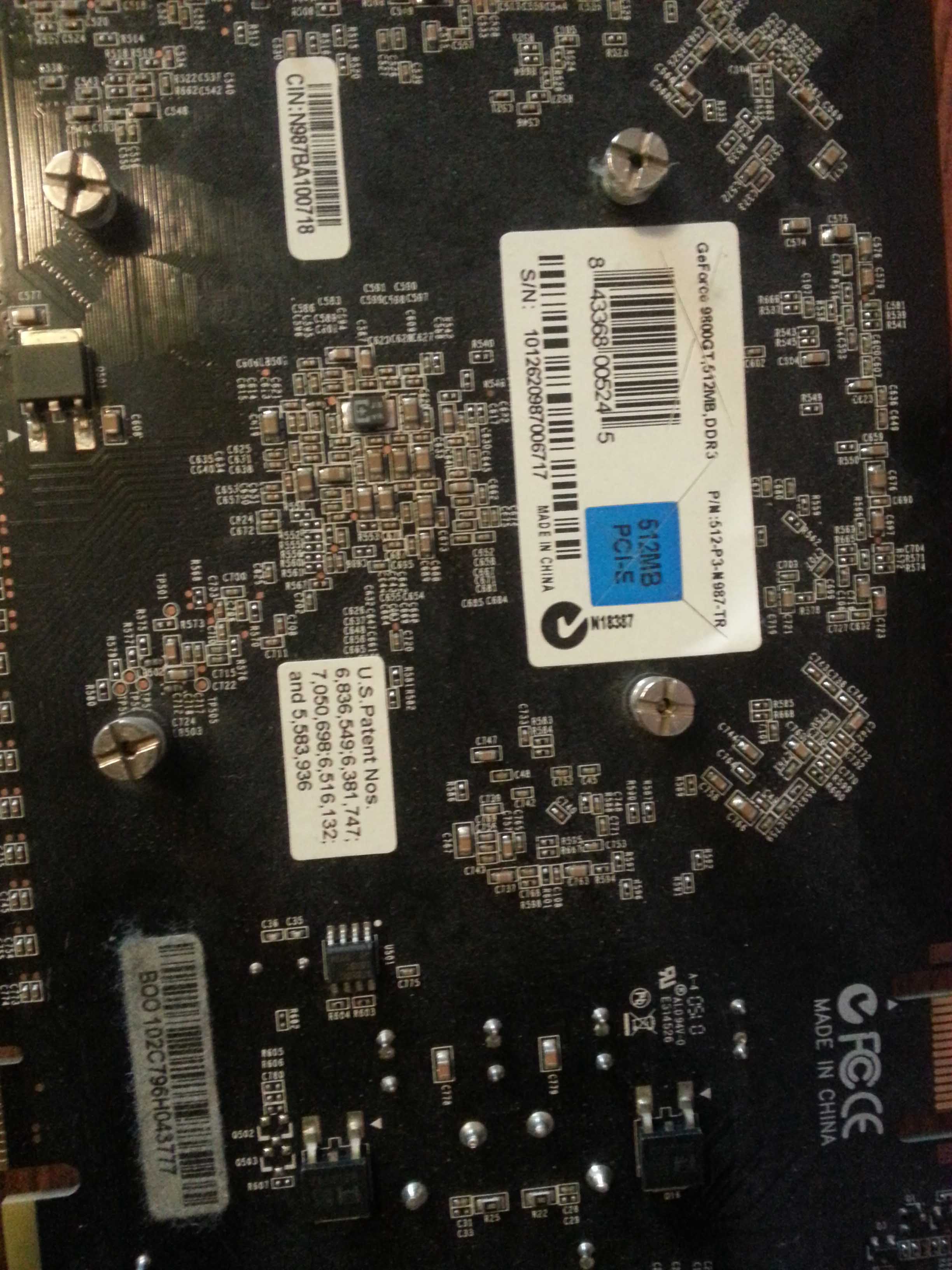

    Also, here are some shots of the GPU in question, since I'm not sure exactly what info you want.
  11. Sniper
    right, ok, setting it to PCIEx should have done the trick (past experience suggests), maybe try disabling it via the device manager in windows 7.

    1) If the GPU is not installed and the BIOS is set to use the onboard VGA, the onboard VGA will work just fine, at native resolution. The VGA controller shows up in the device manager, and there is no issue with the PCI-to-PCI bridge either.
    2) If the GPU is installed and the BIOS is set to use the PCIEx slot, the display defaults to 800x600, and neither the VGA controller or my GPU show up in the device manager. Additionally, the PCI-to-PCI bridge error returns.

    Also, uninstalling and reinstalling both PCI-to-PCI bridges produced no effect, the error comes back.
