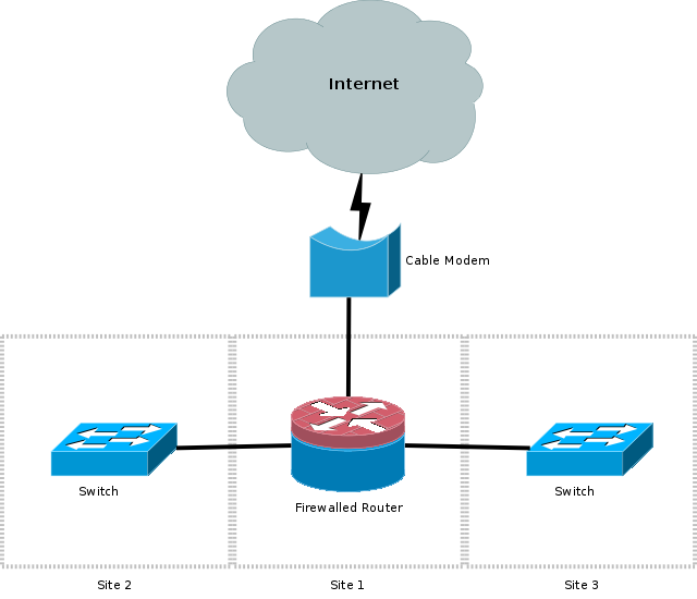

  4. Anti-Trend
    I've attached a diagram showing what I mean. Basically once you get the network connection to them, they can connect using cables, drop a WAP in there, whatever.

    Hmm AT, they already have 2 routers. Your setup would make one of the routers useless and would require buying 2 switches, if I understand you right? Isn't it possible to use what they already have by making one router act as the "main" router (connected directly to modem) and then making the other router act as a switch (not connected to modem but only to the "main" router)? Not sure how to do it, but it is definitely possible to network multiple routers together in a LAN, isn't it?
  6. Anti-Trend
    Yup.
    Depends on the router, but seems pretty ghetto just to save $10.
    Yes, but you don't want to double-NAT traffic, or you'll start to have trouble with various web services.
    Again, all that just to save a few bucks on a switch? Doesn't seem worth it to me, which is why I didn't suggest it. You'd have to pay me a lot more than $10 to troubleshoot network problems because somebody reset a plastic router back to factory defaults and it started serving DHCP. Better to just use the right tool for the job rather than have to go back and fix it later.
