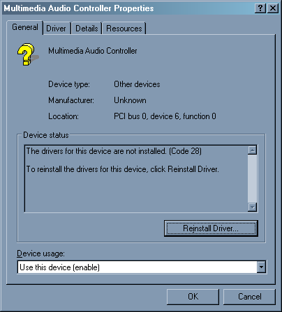

The error code is 28. You can see in the attached screenshot.
