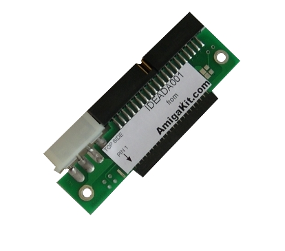

    I have some important stuff on there which I'm convinced I've lost but I bought a 2.5inch to 3.5inch Hard Drive Adaptor
    Maplin > 2.5inch to 3.5inch Hard Drive Adaptor
    problem is I have no idea what to do with it/where to plug it in etc (its an old toshiba satelite laptop)

    Well that link doesnt work but anyway I think I know what you are aiming at.
    You need to take your HDD out of your laptop - there will hopefully be some screws holding a plate in on the under-side of the Toshiba, some laptops have the hard drive sliding out of the side - you'll have to work it out.
    Then plug the 2.5'' adapter end into the removed laptop HDD (thus giving you a 3.5'' connector) with this done you can now plug that hard drive into a spare IDE cable inside a PC, start it up and if it is XP it should automatically recognise the laptop HDD and give you access to it.
    It you have really done a number on the HDD then it may not be accessible in windows and you may have to use some data recovery software to retrieve your files.
    Good luck :)
    ps. if your adapter looks like this
    Remember to plug a spare molex power connector (that runs from the PC's power supply - you'll see lots of them and hopefully will have one free)
