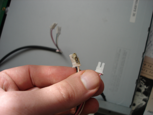

Hi,
My LCD monitor is not working. I have taken it apart and found an internal plug is all corroded. I want to replace this plug but I don't know what type of plug it is and without the name of it I can't search on the internet for a store that will sell me a replacement.
Does anyone know what it is? See the picture attachment.
Any help would be appreciated.

Thats quite a common plug. I dont think they have a specific name. Its just a 2 pin pcb plug. Usually used for low voltage power supply.

Do you know how or why it is burned out? That plug will probably connect to the inverter board. Inverters often die on LCD monitors.

It only has about 2.5-3 inches on cable attached but that can be easily extended.

I got the plug in the mail today. I have installed it in my monitor and it works now! YAY! :D
