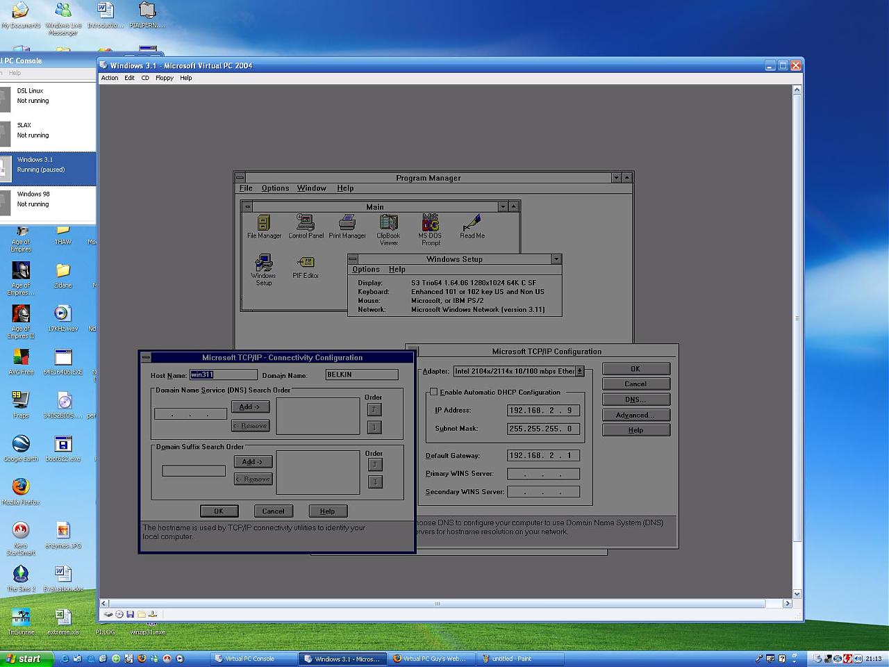

    I've downloaded Virtual PC (thanks to mega for letting us know it's free), and installed Windows 3.11 for Workgroups. It all works fine, and I've managed to get the Video drivers installed. I'm now trying to setup the network (and eventually the internet) by following this guide, but I've got to step 17, and it wants a 'DNS Search Order' :confused: I've got a Belkin wireless router, but the computer I'm using is wired to the router. Does anyone have any idea what I'm meant to be putting here? I've attached a pic, but the virtual machine is greyed out because I had to pause it to get a print screen.
    Thanks, Thomas.

    To answer your question, put the IP address of your gateway (or router) in the DNS Search Order box

    Thanks for your help, worked a treat and now I can ping my router and get a reply.
