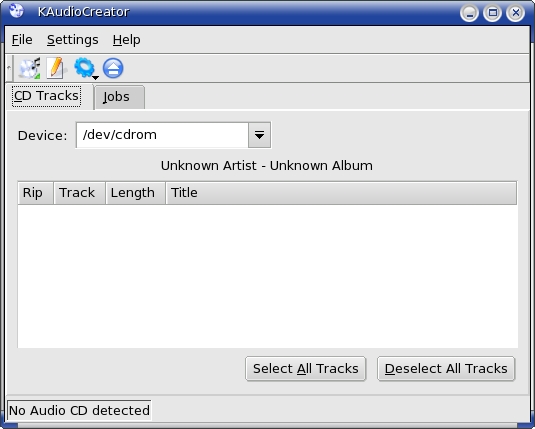

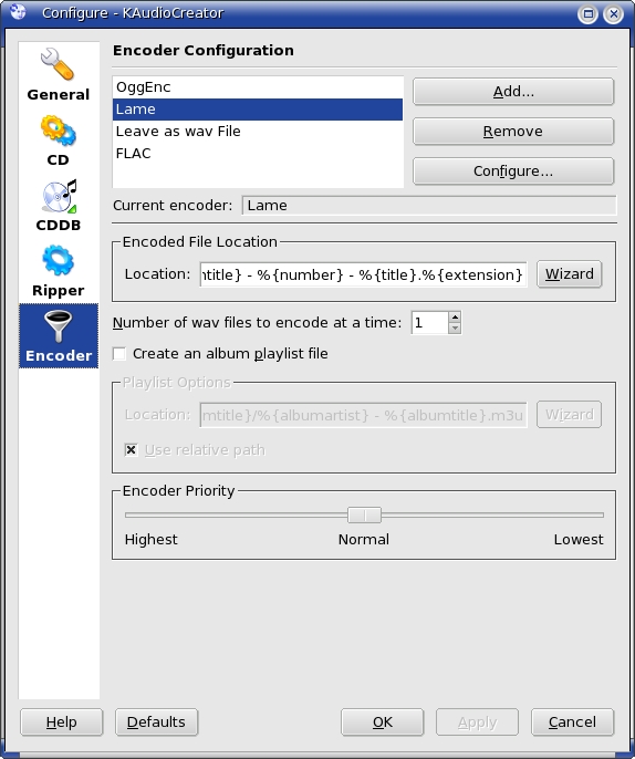

Please see attached the screen shots of my KAC:
I hope these are in the right order....
1st is the main screen. Just click on Settings.
2nd is the settings screen with the encoder option showing.
3rd is the actual encoder adding dialogue box.
Just follow the example.
I added the following string to the command line:
lame -b 320 --tn %{number} --tt %{title} --ta %{artist} %f %o
This will create a file which is 320 Kbps CBR and will tag it - x. title - artist.
However, Lame has a vast amount of filters and manipulations which a humble user might never even conceder....
Please post any further questions and I will do my best to answer... :cool:

Yes i've seen that before, but I didn't realise that's where you entered the bit-rate information!
How would I manipulate that, so it encodes a constant 192Kb/s and names the files and folders as such:
Favourite Artist/Favourite Album/01 - Good song.mp3
It is farely simple.
Where you see that I have entred 320 just change to 192 or 160 or XXX.
basicaly the flag -b forces a CBR. The rest of the line i.e. --tn %{number}
means track number = enter number of track and so forth.
As for the directories - this will be determined by the wizard which is in the encoder configuration main screen (second image I think). Click on the wizard button and try and understand the way the wizard works. It took me a few trials and errors before I got it properly but it is logical. You can follow the example and basicaly save it anywhere by entering the right path.
Default is home i.e. ~/ %{bla}/%{bla} and so forth...
It took me around 15 minutes to work out. For you not more than 5.... ;)
